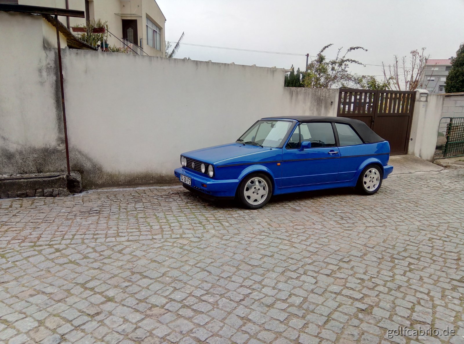

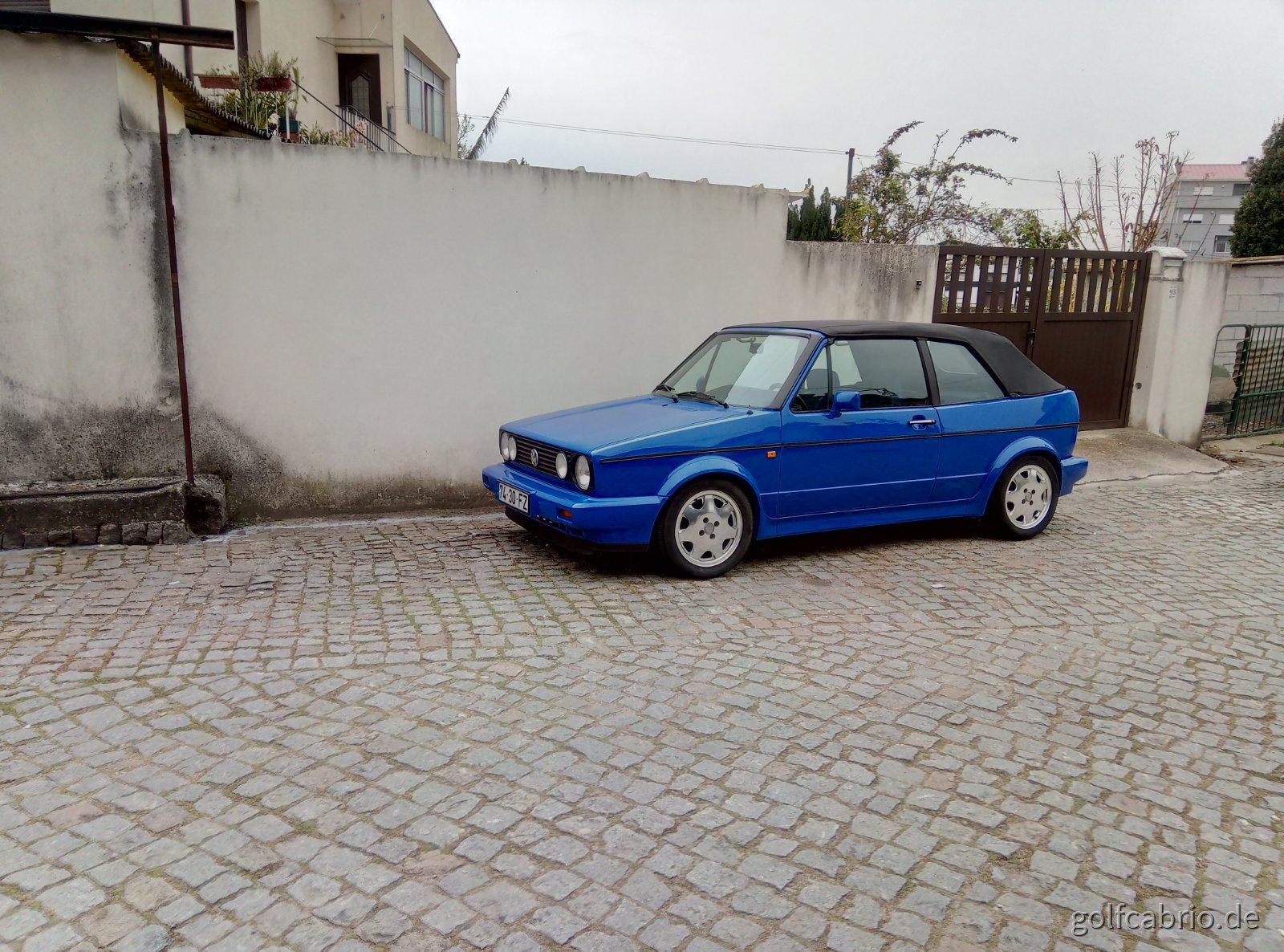

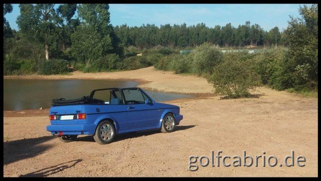

A brilliant choice for the color my friend
May i ask you which color-code that is ?
Kind regards to Porto

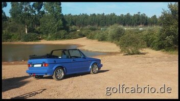

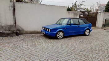

Hello PHOENIX, sadly I am not 100% sure about the color, it's not original(I think).
From my search and comparison side by side with cars it is Porsche's Maritime Blau, but not sure, this car came from germany, used to belong to a portuguese doctor, first and only owner before me, he was living in germany and he had change the car a little bit, he also owned 1 porsches in this same colour, 964 carrera, side by side the cars look the same, I think it's the same colour, the guy had a "thing" about this color.

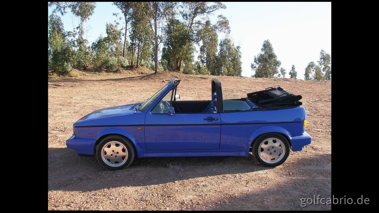

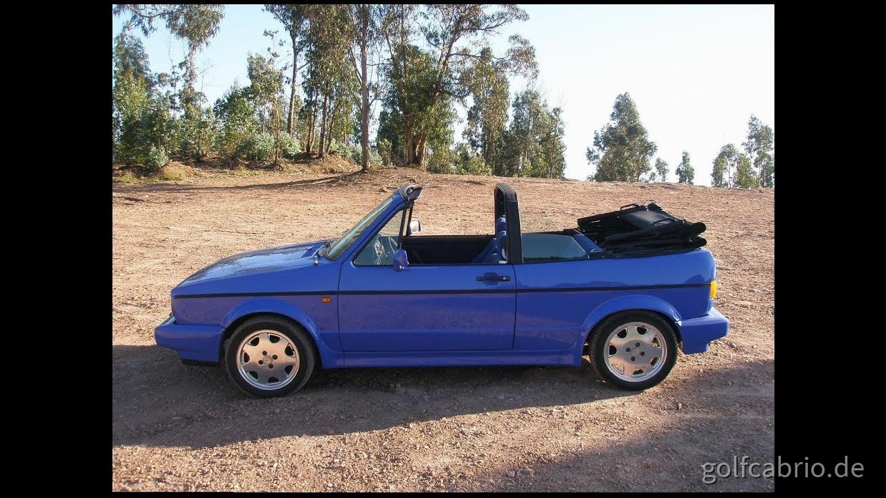

Hello mauben, it's very hard to understand the color from the car is this pictures, light and camera makes big changes in the look, check the following pictures and also the ones in the top of the topic.
More pictures:
Wonderful pictures indeed !

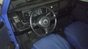

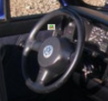

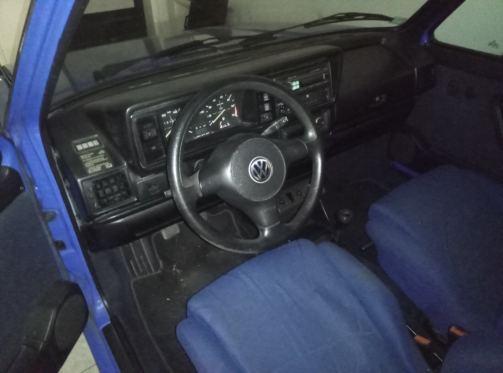

What is that for a steering wheel ?

About the steering wheel, I bought the car already with it is from a VW polo, I dont like it, I Will replace it One day with the original, but for now is OK, I only care about car mechanics and driving experience.

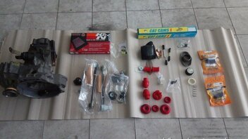

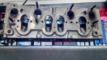

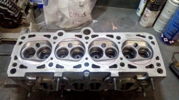

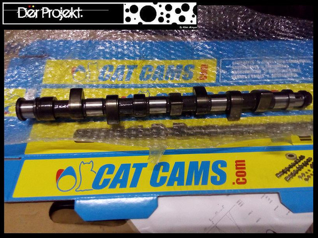

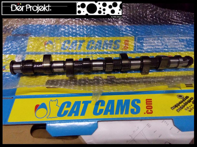

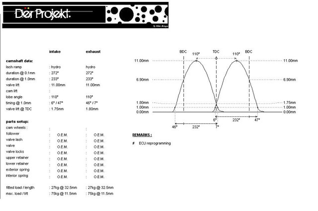

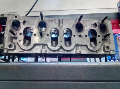

My goal is to finish the 2E that I am rebuilding and adding some mild street tuning.

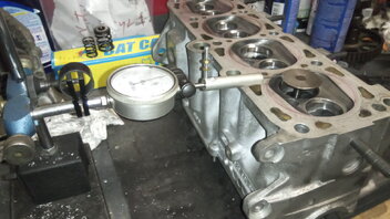

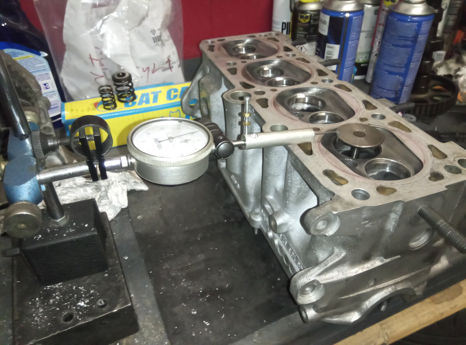

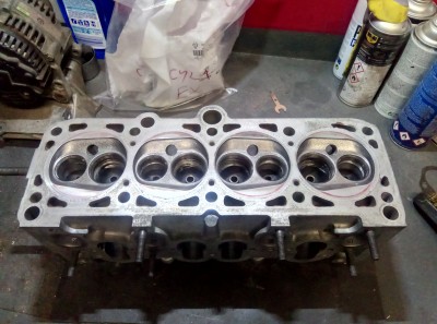

I have ported the head, changed the valve guides, new valves, new stem seals, now it is at a machine shop to skim the head surface and correct the volume of the combustion chamber to make a little increment in the compression ratio.

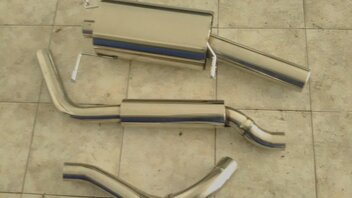

I need now to find a solution for my exhaust manifold, I need to increase the exhaust flow, I do have the 2E exhaust manifold but I dont know if its a good or bad ideia, or if I should look instead for a performance one, no idea where to go, I have to search in this forum, seems like 2E conversion is quite popular here but I didnt find yet many pictures.

Some people may not have this idea but the purpose of a good exhaust is not only to allow exhaust gases to go out but also help promote scavenging.
I made this vídeo using the standard exhaust manifold and downpipe from a 2E engine.
The 2H does not promote any scavenging, actually it restricts the gases from what I have tested.
I dont know yet if the 2E manifold is indeed a good option, i dont know if it fits, thats why I am looking for other options on the market to Cope whit my tuned head and sport/street camshaft, I AM not looking for big gains, just a little bit extra.

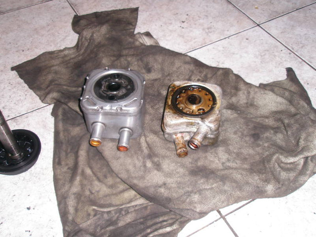

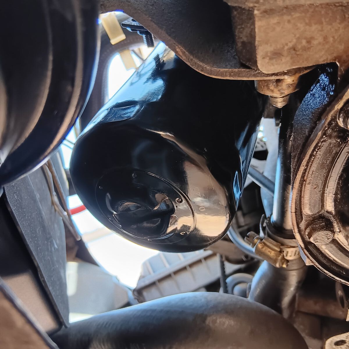

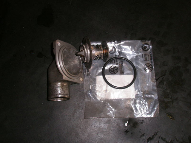

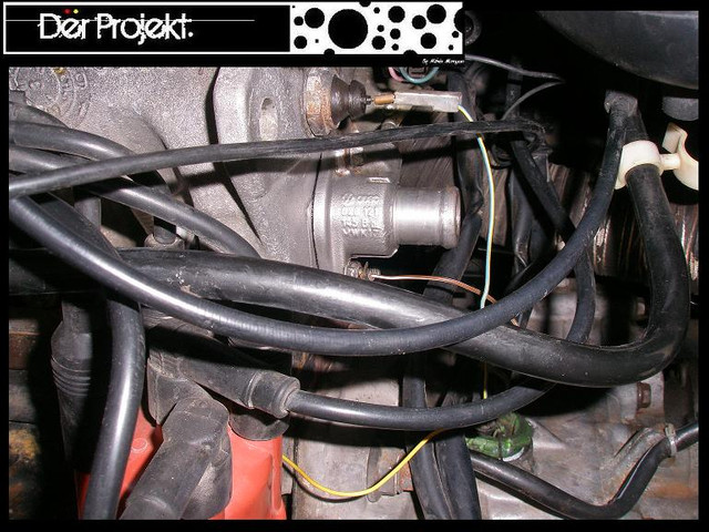

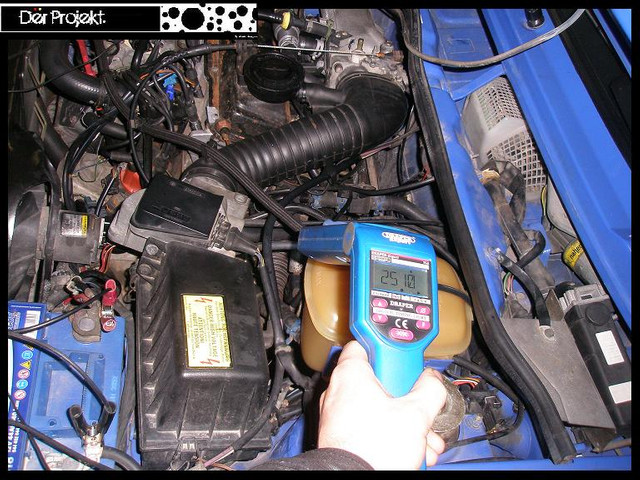

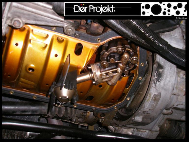

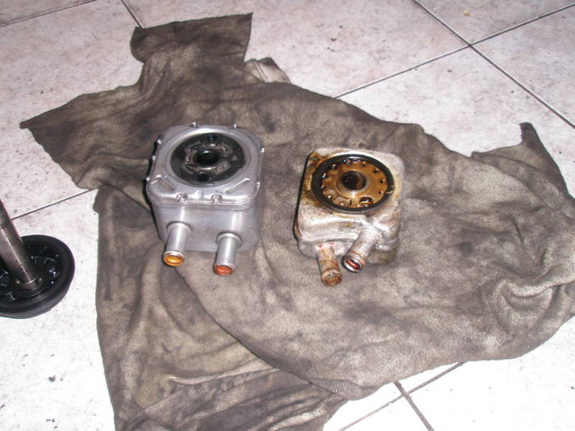

More pictures about work that has been already done. The cooling system has been improoved, air guides forcing air into the radiador have been installed, aluminium thermostat housing from golf mk3 GTI 16v, aluminium cooling flange on the cylinder head, tdi oil cooler, g13 coolant, oil sump splash guard, and other things.
This made a big noticeable improvement on the coolant and oil temperatures, a good 20degrees reduction in the max oil temperature when driving very hard.

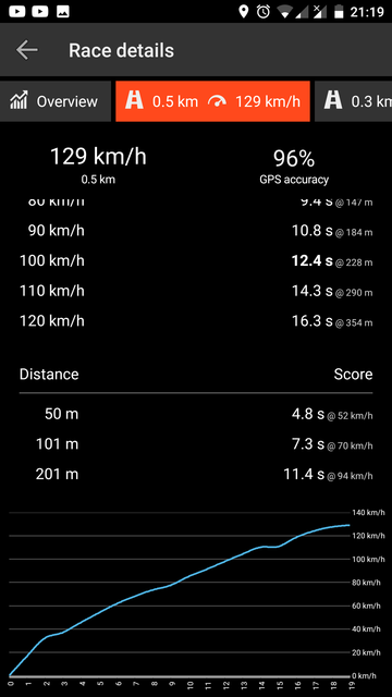

Hello, I've been away for a long time, and there are some updates about this "project car".

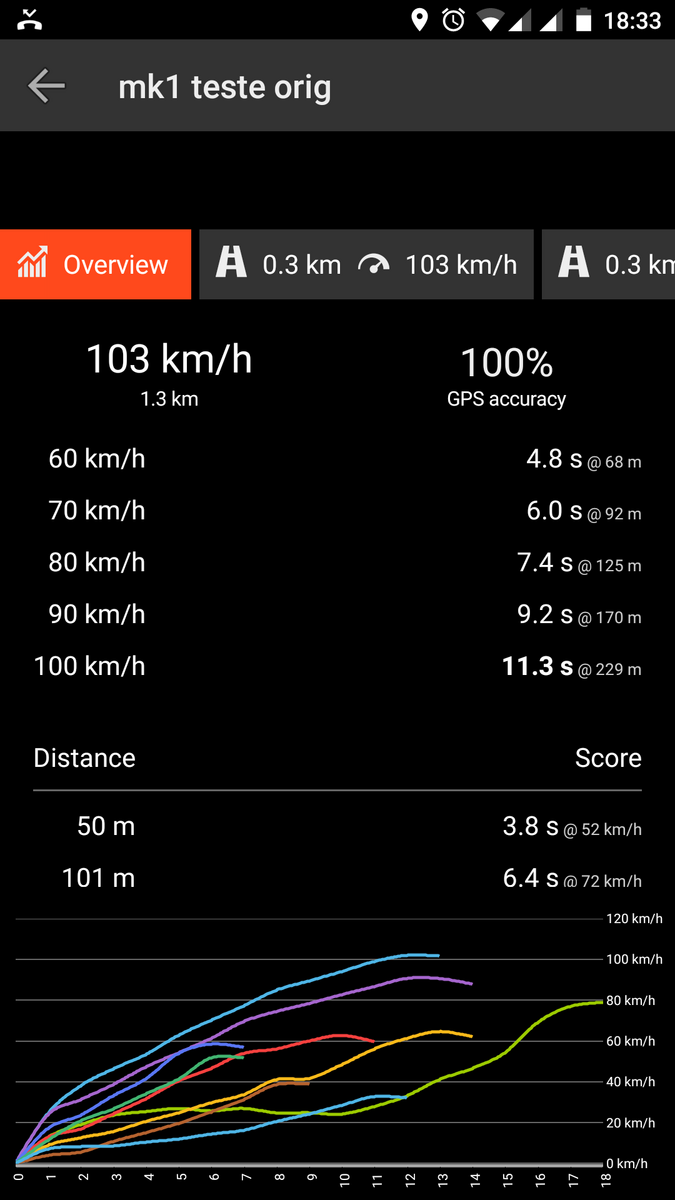

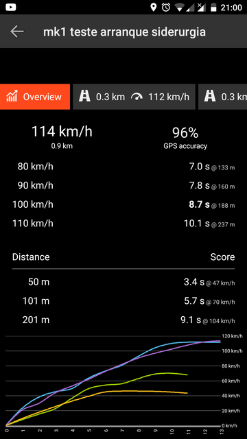

Some performance measurements, during the measurements, I found out that my tacho has a big error in speed(probably most cars have, mine has 15" wheels), when it displays the needle at 100kmh, it's actually around 89/92kmh, I did the testing using a military spec GPS.

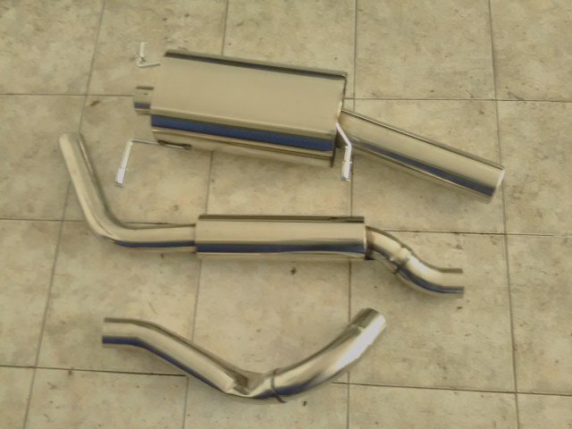

Specs: Group A exhaust(stock 2h manifold with Kat), K&N filter, BB chip

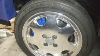

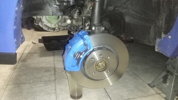

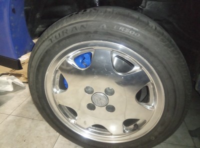

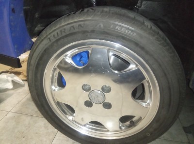

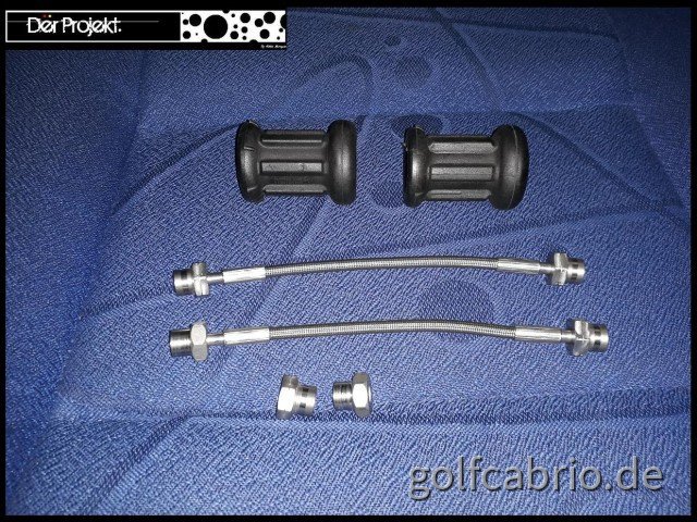

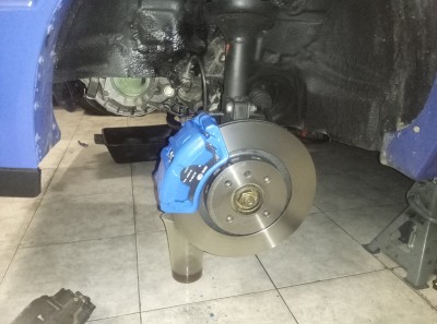

Specs: Group A exhaust(stock 2h manifold with Kat), K&N filter, BB chip + Big brake kit!(big brake kit made the car slower by a lot!!!)
Specs: Group A exhaust(stock 2h manifold with Kat), K&N filter, stock chip + Big brake kit + Ignition Tuning + ngk iridium spark plugs + cam timing retard + Venturi in the LMM
Hallo allerseits, ich habe mich entschieden, diese Informationen zu teilen, weil ich dachte, dass sie ein gewisses Interesse und eine Interaktion Ihrerseits haben, obwohl nur ein Test mit jeder der Konfigurationen veröffentlicht wurde, wurden mehrere Tests durchgeführt, um zu überprüfen, ob die Ergebnisse konsistent sind. leider schreibe und spreche ich schlecht deutsch, deshalb werde ich den Google-Übersetzer verwenden, um bei der Übersetzung zu helfen. Ich entschuldige mich, wenn die Texte Fehler enthalten.

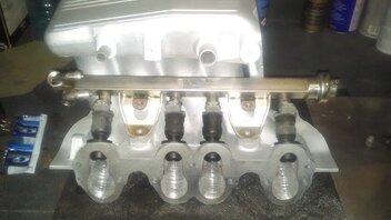

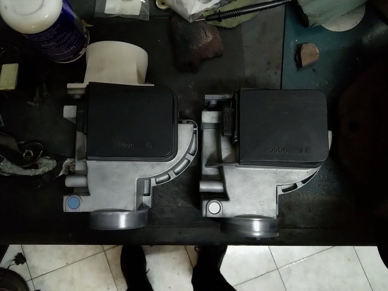

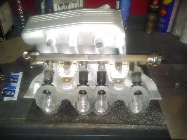

Diffusor am Einlass des Luftmassenmessers installieren
Bestimmen Sie die Abmessungen der Abgaskrümmerkanäle

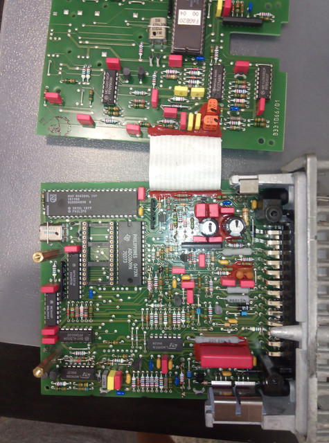

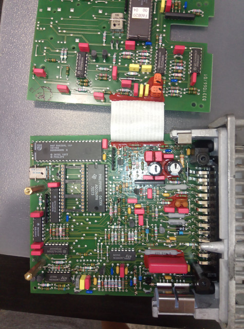

Elektrischer Überholungsservice
