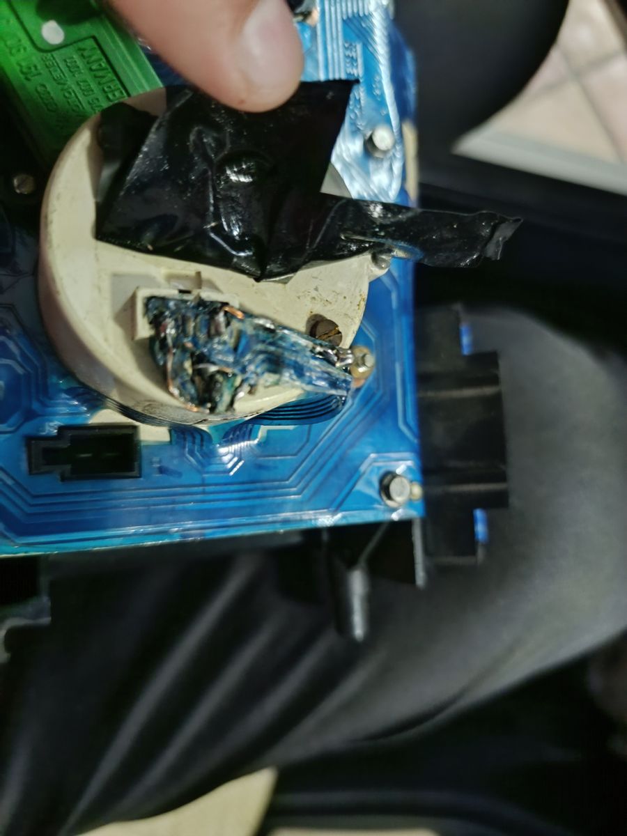

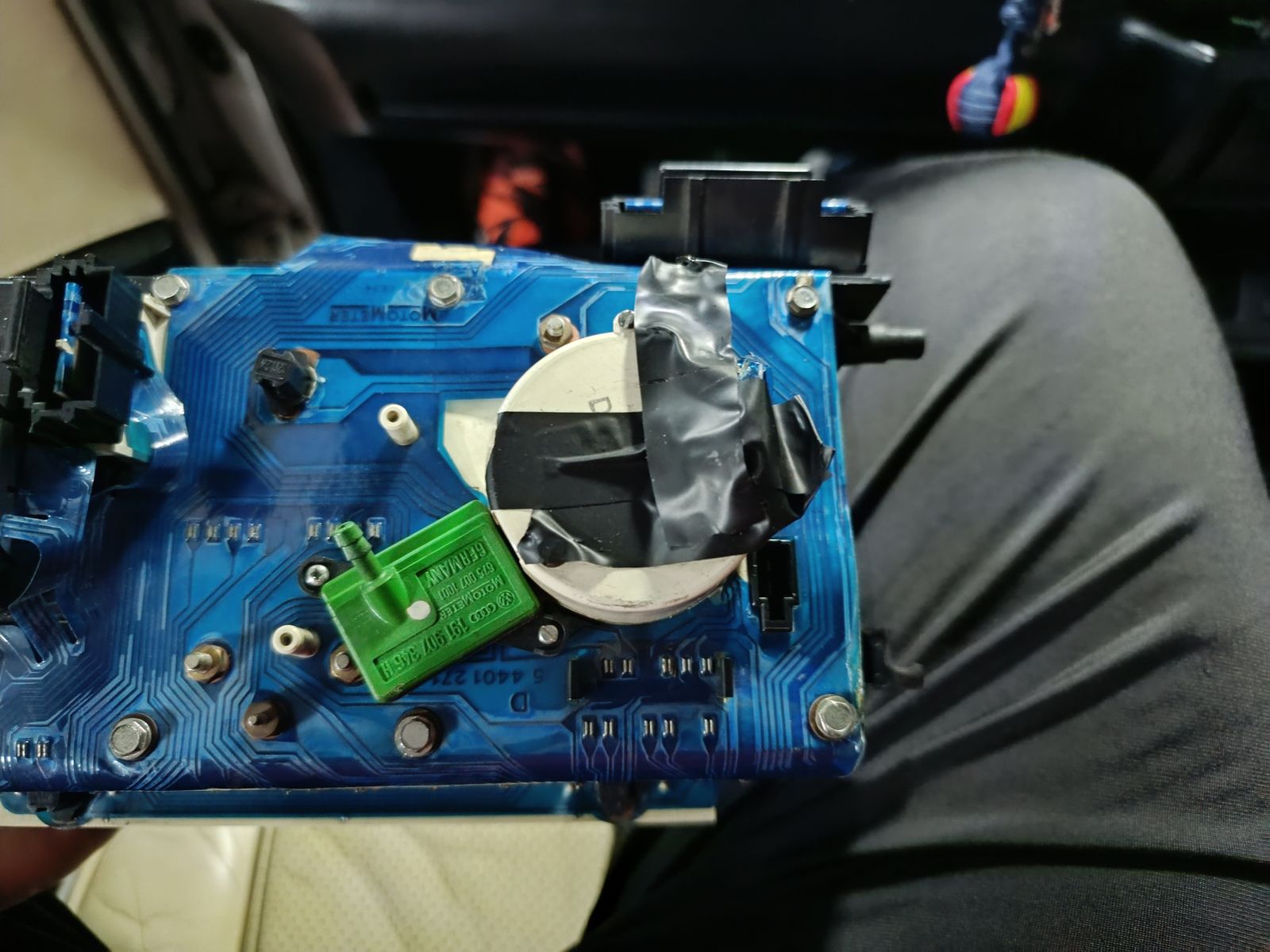

    Thanks a lot for your information, I will try to contact kay_algeciras.
    Well, I think it is the reason why the MFA doesn´t work. I buy the car one month ago, and i am happy, i works well for a car with 34 years. I start to change the bulbs of the cluster and I found what you can see in the pictures . Everything works, only the information of the MFA.
    It is not important because I want to install the original gauges, but....
    The P/N of the cluster i will check. The car is from 1990 measure in km, digital clock and MFA, no airbag.
    Thanks and stay in contact
